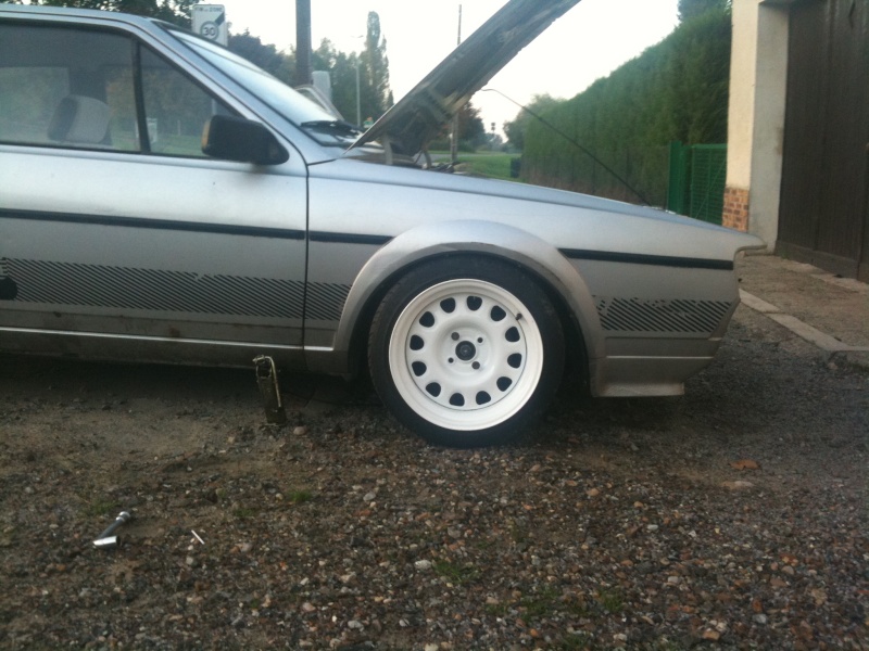

Jeu 12 Aoû 2010 - 16:19
Quelques photos avec la nouvelle suspension et lors d'un démontage d'un des ressorts de devant pour récupérer la tête, je pme suis prit un jolie ressort en pleine tête avec en plus 4 fils :? mais rien de grave je suis un dur
[url=https://servimg.com/image_preview.php?i=195&
u=14656104]
[url=https://servimg.com/image_preview.php?i=196&
u=14656104]

enfin j'ai réussi a avoir les jantes que je voulais essayer:twisted:
[url=https://servimg.com/image_preview.php?i=238&
u=14656104]
[url=https://servimg.com/image_preview.php?i=239&
u=14656104]
[url=https://servimg.com/image_preview.php?i=240&
u=14656104]
[url=https://servimg.com/image_preview.php?i=241&
u=14656104]
[url=https://servimg.com/image_preview.php?i=242&
u=14656104]
[url=https://servimg.com/image_preview.php?i=243&
u=14656104]
[url=https://servimg.com/image_preview.php?i=244&
u=14656104]
[url=https://servimg.com/image_preview.php?i=245&
u=14656104]
[url=https://servimg.com/image_preview.php?i=246&
u=14656104]
u=14656104]
![scirocco 2 gts montage rampe carbu weber by g2gti - Page 2 Img_0614](https://i.servimg.com/u/f25/14/65/61/04/img_0614.jpg)
u=14656104]
![scirocco 2 gts montage rampe carbu weber by g2gti - Page 2 Img_0615](https://i.servimg.com/u/f25/14/65/61/04/img_0615.jpg)
u=14656104]
![scirocco 2 gts montage rampe carbu weber by g2gti - Page 2 Img_0616](https://i.servimg.com/u/f25/14/65/61/04/img_0616.jpg)
u=14656104]
![scirocco 2 gts montage rampe carbu weber by g2gti - Page 2 Img_0617](https://i.servimg.com/u/f25/14/65/61/04/img_0617.jpg)
u=14656104]
![scirocco 2 gts montage rampe carbu weber by g2gti - Page 2 Img_0618](https://i.servimg.com/u/f25/14/65/61/04/img_0618.jpg)
u=14656104]
![scirocco 2 gts montage rampe carbu weber by g2gti - Page 2 Img_0619](https://i.servimg.com/u/f25/14/65/61/04/img_0619.jpg)
u=14656104]
![scirocco 2 gts montage rampe carbu weber by g2gti - Page 2 Img_0620](https://i.servimg.com/u/f25/14/65/61/04/img_0620.jpg)
u=14656104]
![scirocco 2 gts montage rampe carbu weber by g2gti - Page 2 Img_0621](https://i.servimg.com/u/f25/14/65/61/04/img_0621.jpg)
u=14656104]
![scirocco 2 gts montage rampe carbu weber by g2gti - Page 2 Img_0622](https://i.servimg.com/u/f25/14/65/61/04/img_0622.jpg)
- max2hotGolfoo d'argent confirmé
- Messages : 558
Date d'inscription : 11/06/2009
Localisation : Limoges 87
Re: scirocco 2 gts montage rampe carbu weber by g2gti
Dim 10 Oct 2010 - 14:11
bien sympa comme sa, sa lui donne un look racing je trouve!!!
- G2GTIGolfoo d'argent confirmé
- Messages : 552
Date d'inscription : 26/05/2008
Localisation : Aisne LAON
Dim 10 Oct 2010 - 21:54
Oui c'est pas mal comme sa, mais c'est pas mes jantes, mais ceux a tougas.
Jespère qu'il va me les donner :mdr:
