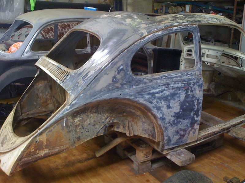

bon voici ma nouvelle acquisition d'une cox decouvrable de aout 1959 arriver tout droit du portugal
[url=https://servimg.com/image_preview.php?i=2125&
u=11571358]Black Pearl Img_0422[/url]
Jeudi 27 Mai a son arrivée
[url=https://servimg.com/image_preview.php?i=2126&
u=11571358]Black Pearl Img_0423[/url]
[url=https://servimg.com/image_preview.php?i=2128&
u=11571358]Black Pearl Img_0425[/url]
hé hop hop hop pas de temps a perdre aussitot arrivée aussitot demonter
[url=https://servimg.com/image_preview.php?i=2129&
u=11571358]Black Pearl Img_0537[/url]
[url=https://servimg.com/image_preview.php?i=2130&
u=11571358]Black Pearl Img_0538[/url]
[url=https://servimg.com/image_preview.php?i=2131&
u=11571358]Black Pearl Img_0539[/url]
[url=https://servimg.com/image_preview.php?i=2132&
u=11571358]Black Pearl Img_0540[/url]
[url=https://servimg.com/image_preview.php?i=2133&
u=11571358]Black Pearl Img_0541[/url]
moment de verité !!!!!! longerons, chassi plus que sain !!!!!!
[url=https://servimg.com/image_preview.php?i=2134&
u=11571358]Black Pearl Img_0542[/url]
[url=https://servimg.com/image_preview.php?i=2135&
u=11571358]Black Pearl Img_0543[/url]
[url=https://servimg.com/image_preview.php?i=2137&
u=11571358]Black Pearl Img_0545[/url]
[url=https://servimg.com/image_preview.php?i=2138&
u=11571358]Black Pearl Img_0546[/url]
[url=https://servimg.com/image_preview.php?i=2139&
u=11571358]Black Pearl Img_0547[/url]
p'tit coup de karsher a eau chaude sur le chassi pour un bon decrassage a 2H du mat'
[url=https://servimg.com/image_preview.php?i=2136&
u=11571358]Black Pearl Img_0544[/url]
goutiere dans le compartiment moteur abimée aussitot reparer
[url=https://servimg.com/image_preview.php?i=2140&
u=11571358]Black Pearl Img_0548[/url]
[url=https://servimg.com/image_preview.php?i=2141&
u=11571358]Black Pearl Img_0549[/url]
[url=https://servimg.com/image_preview.php?i=2142&
u=11571358]Black Pearl Img_0550[/url]
[url=https://servimg.com/image_preview.php?i=2143&
u=11571358]Black Pearl Img_0551[/url]
[url=https://servimg.com/image_preview.php?i=2144&
u=11571358]Black Pearl Img_0552[/url]
fin de cette première journée
[url=https://servimg.com/image_preview.php?i=2145&
u=11571358]Black Pearl Img_0553[/url]

3 parties malade a l'endroit du decouvrable
[url=https://servimg.com/image_preview.php?i=2146&
u=11571358]Black Pearl Img_0554[/url]
[url=https://servimg.com/image_preview.php?i=2147&
u=11571358]Black Pearl Img_0555[/url]
[url=https://servimg.com/image_preview.php?i=2148&
u=11571358]Black Pearl Img_0556[/url]
[url=https://servimg.com/image_preview.php?i=2149&
u=11571358]Black Pearl Img_0557[/url]
[url=https://servimg.com/image_preview.php?i=2150&
u=11571358]Black Pearl Img_0558[/url]
[url=https://servimg.com/image_preview.php?i=2151&
u=11571358]Black Pearl Img_0559[/url]
ted old vw crew
Messages : 151
Date d'inscription : 07/04/2009
Localisation : reims
Black Pearl Empty Re: Black Pearl
Jeu 3 Juin 2010 - 21:50
l'interieur est fini de ponser, pret a peindre ;
l'etat des longerons d'origine Very Happy Very Happy Very Happy
[url=https://servimg.com/image_preview.php?i=2152&
u=11571358]Black Pearl Img_0619[/url]
[url=https://servimg.com/image_preview.php?i=2153&
u=11571358]Black Pearl Img_0620[/url]
une fleche de deboucher
[url=https://servimg.com/image_preview.php?i=2155&
u=11571358]Black Pearl Img_0561[/url]
debut de decapage de l'arriere
[url=https://servimg.com/image_preview.php?i=2156&
u=11571358]Black Pearl Img_0562[/url]
bac a roue de secours casie fini de souder
[url=https://servimg.com/image_preview.php?i=2157&
u=11571358]Black Pearl Img_0563[/url]
[url=https://servimg.com/image_preview.php?i=2158&
u=11571358]Black Pearl Img_0564[/url]

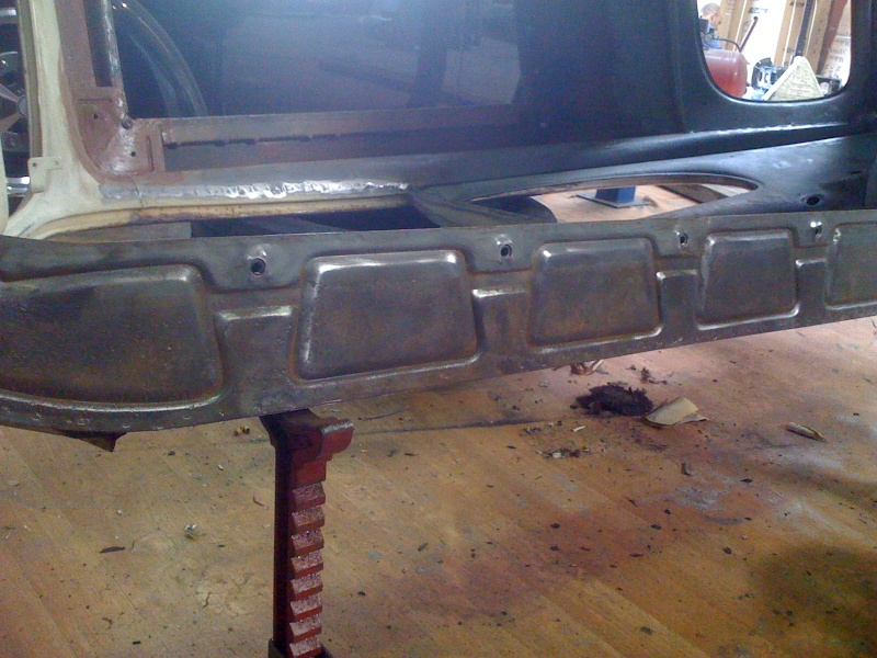

[url=https://servimg.com/image_preview.php?i=2160&
u=11571358]Black Pearl Img_0622[/url]
[url=https://servimg.com/image_preview.php?i=2161&
u=11571358]Black Pearl Img_0623[/url]
[url=https://servimg.com/image_preview.php?i=2162&
u=11571358]Black Pearl Img_0624[/url]
[url=https://servimg.com/image_preview.php?i=2164&
u=11571358]Black Pearl Img_0626[/url]
bac avant fini
dépointage de la jupe
[url=https://servimg.com/image_preview.php?i=2165&
u=11571358]Black Pearl Img_0627[/url]
[url=https://servimg.com/image_preview.php?i=2166&
u=11571358]Black Pearl Img_0628[/url]
[url=https://servimg.com/image_preview.php?i=2167&
u=11571358]Black Pearl Img_0629[/url]
changement du support de pare choc droit
[url=https://servimg.com/image_preview.php?i=2168&
u=11571358]Black Pearl Img_0630[/url]
[url=https://servimg.com/image_preview.php?i=2169&
u=11571358]Black Pearl Img_0631[/url]
verification avec l'aile voir si les trou sont bien en face
[url=https://servimg.com/image_preview.php?i=2170&
u=11571358]Black Pearl Img_0632[/url]
[url=https://servimg.com/image_preview.php?i=2171&
u=11571358]Black Pearl Img_0633[/url]

Mar 8 Juin 2010 - 20:47
aujourd hui fini de decaper le toit et le coté droit
[url=https://servimg.com/image_preview.php?i=2188&
u=11571358]Black Pearl Img_0641[/url]
[url=https://servimg.com/image_preview.php?i=2184&
u=11571358]Black Pearl Img_0710[/url]
[url=https://servimg.com/image_preview.php?i=2189&
u=11571358]Black Pearl Img_0642[/url]
[url=https://servimg.com/image_preview.php?i=2186&
u=11571358]Black Pearl Img_0712[/url]
[url=https://servimg.com/image_preview.php?i=2181&
u=11571358]Black Pearl Img_0637[/url]
[url=https://servimg.com/image_preview.php?i=2183&
u=11571358]Black Pearl Img_0639[/url]
[url=https://servimg.com/image_preview.php?i=2187&
u=11571358]Black Pearl Img_0640[/url]
[url=https://servimg.com/image_preview.php?i=2185&
u=11571358]Black Pearl Img_0711[/url]

Mar 15 Juin 2010 - 20:40
[url=https://servimg.com/image_preview.php?i=2201&
u=11571358]Black Pearl Img_0724[/url]
[url=https://servimg.com/image_preview.php?i=2202&
u=11571358]Black Pearl Img_0725[/url]
up up up sur l'coté la grosse
[url=https://servimg.com/image_preview.php?i=2203&
u=11571358]Black Pearl Img_0726[/url]
[url=https://servimg.com/image_preview.php?i=2204&
u=11571358]Black Pearl Img_0727[/url]
les longerons avant et apres
[url=https://servimg.com/image_preview.php?i=2205&
u=11571358]Black Pearl Img_0728[/url]
[url=https://servimg.com/image_preview.php?i=2206&
u=11571358]Black Pearl Img_0729[/url]
[url=https://servimg.com/image_preview.php?i=2207&
u=11571358]Black Pearl Img_0730[/url]
[url=https://servimg.com/image_preview.php?i=2208&
u=11571358]Black Pearl Img_0731[/url]
[url=https://servimg.com/image_preview.php?i=2209&
u=11571358]Black Pearl Img_0812[/url]
[url=https://servimg.com/image_preview.php?i=2210&
u=11571358]Black Pearl 29926_10[/url]
